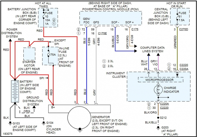

So, the Ford Alternator uses a wiring harness to talk to the car and the car then talks to it to say I need this much power.
Now, this is a simplified diagram, and it's for a typical later year model vehicles' charging system - but what I want you to pay attention to is the wiring and color code - so the wires from your cars alternator can be found and identified - so you can even inspect this yourself.
How this Regulation works is.
The battery puts out power.
The system sees and compares the power level to a known reference.
The system tells the alternator to either boost or reduce the DARK RED wires output by changing the power present on the Red Blue and Grey wires, this changes the power present on the Alternators Output terminal - the Dark Red wire.
The Dashboard (Instrument Cluster) uses a lamp labeled "Charge Indicator" that lights up when things with the charging system are wrong - that lamp shows up as your Battery Icon you see.
