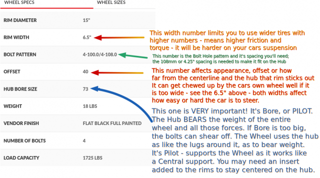

But in regards to "rims" you're pretty much stuck between 15" Steel (some older Alloys are out there) and have the 4-bolt pattern of 4.25" (108mm spacing) and a rim width starting at 6" and goes wider from there - the hole or knockout for the hub is 62mm max. Diameter.
But your main concern would be tire size for those rims, and the "Offset" as in where the hub of the car, meets the hub of the rim, as how far the tire sticks out from the car, onto how far inside or tucked in?

My Fiesta came stock with 16" rims and they were 16 X 6.5 X 4 (108mm) and are alloy - they have a 47mm Positive offset - or Rim center-line to Hub Center-line are nearly spot on in balance - Smaller numbers will affect the balance the wheel will feel in your hands as well as how hard or how much effort it will take - to turn those wheels.
I have several posts 'bout those tires Ford chose to put on there. There were Toyo Optimo and must have had a 40,000 mile warranty. They barely lasted that duration. And they suffered being under the car in Michigan roads in winter and summer conditions - being 195 - 50 R16 with a +47mm Offset (Tucked in direction) - This was Ford's choice. I learned a lot remembering that...
Got better tires using 185 60 R16 on those OEM rims and even went out shopping and bought 15" steel - stock rims of that 15 x 6" x 4 (108) and use now 185 x 65 R15 and kept the 47mm Positive offset for balance and operation to help in winter. I then swap out the winter for summer tires using the OEM 16" rims I got with the car. I went with 60 and 65 percentage numbers on a Narrower tire to reduce the torque steering I got from the wider tires (195 width) on rough and rutted bumpy roads - which helps in controlling your vehicle from becoming a mess in a skidding condition - as well as kept similar height and perimeter (How far it travels per number of turns) so it doesn't affect the odometer and speedometer readings.
