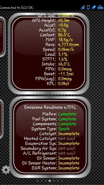

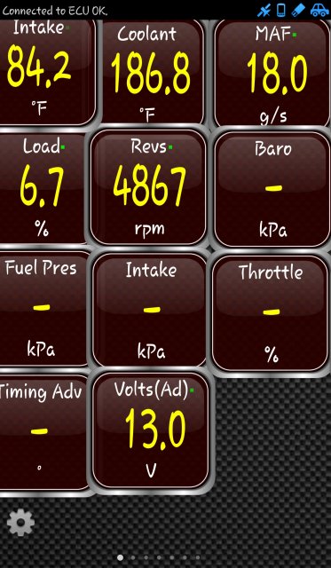

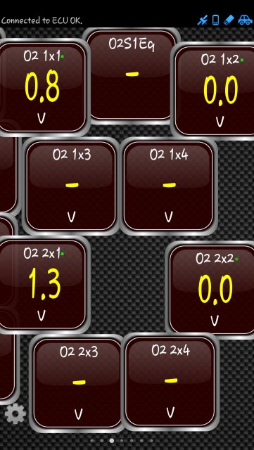

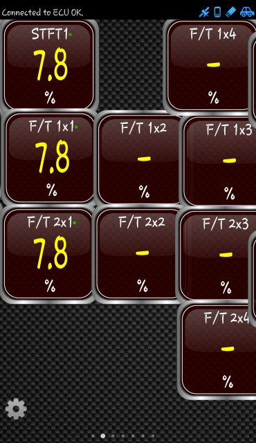

I have an identical problem with my '01 2.0, are the steps the same to diagnose?
No codes as I had just put the battery in.
Oil Level is fine.
My coolant bottle is dirty, but has been that way for probably the last 80k miles (212k on the vehicle)
I have a Bluetooth scanner that I can read all the sensors with, the voltages read as soon as I plug it in/start it. I did notice when I unplug my tps, there is no change on how the engine is running though.
The car ran fine until I replaced the starter, in doing so I pulled the intake manifold, and then had to replace the throttle body after cracking the original when trying to remove it.
I have checked in every possible way for vacuum leaks, but with the RPMs up this high, it would have to be a huge frigging leak, and I'm not finding anything using starting fluid.
Unlike his car, my RPM's do not creep back down.
This is not an attempt to hijack his thread either, but it didn't make any sense to me to start a new one with a identical issue.
